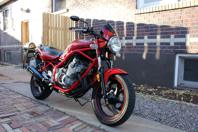

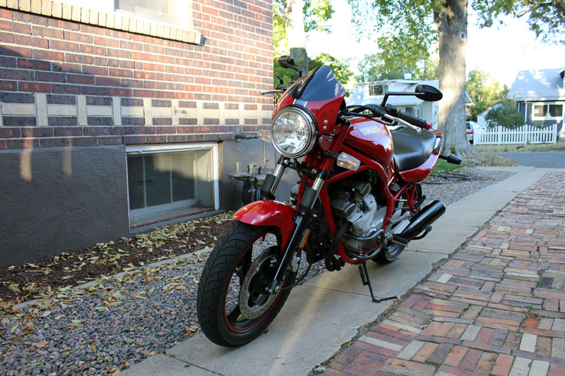

This is kind of what I had in mind; pictures showing the modifications and then a list of what was used so that others might follow. On that note, here's my N conversion.
Mods to get it to the Naked stage:
1. Cut-off and ground down mounts for fairing on sides of frame and below triple.
2. Horn relocated to below the triple and it's mount cut off.
3. Home-made fork tubes/headlamp ears to fit over the 38mm forks.
4. SV650 knockoff headlamp (Made by Delkevic)
5. Holeshot Fairing (Buell Blast knockoff made by Holeshot)
6. FZ600 speedometer and tachometer in custom made housing
7. XT350 Speedometer cable (2" longer than stock cable)
8. Stem-captain clock and thermometer
9. LED indicator lights on custom made housing
10. BikeMaster European bend handlebars
11. Bikemaster Lined-oval mirrors
12.SV650 clutch cover (rubber thing that keeps dirt out of the clutch lever).
13.BMW F650 handlebar mount covers (hide the bolts in the handlebar mounts)
14.EBay aluminum bar ends, anodized red
15.Traxxion Dynamics Fork protectors (for SV650)
16.All-balls taper headset bearings (a "while I was at it" item)
Mods NOT necessarily related to the N conversion:
1. FZR600 rear wheel w/ Brembo rotor
2. V-star rear shock (2007 XVS650)
3. Wheels painted black with red rim tape
4. '97 style tail conversion
5. Custom paint, by me
6. FZR600 fork and brake conversion to follow
7. Center stand added
8. Engine crash guards added
9. Clear signal lenses added
