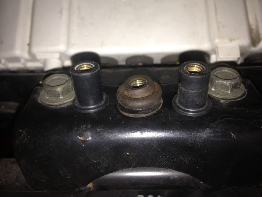

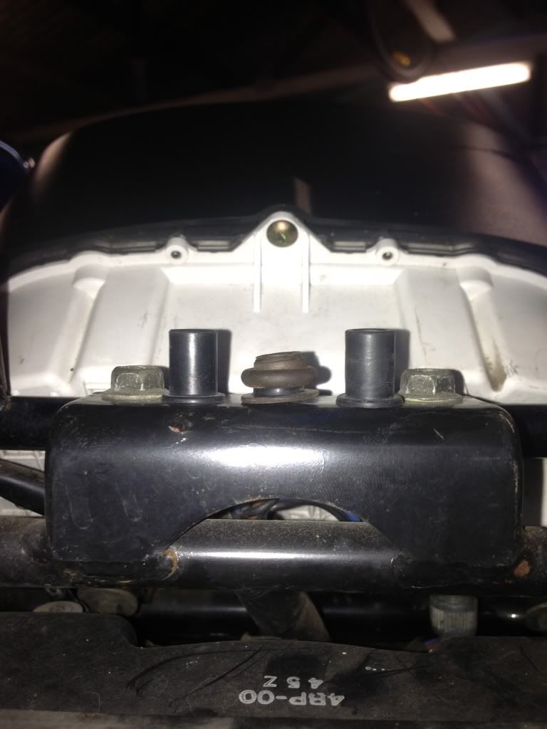

once thats off inspect where the six hex bolts went into if the rubber is volcanised replace them.
here is a photo of two new rubber with the 19 year old one in the middle.. BIG difference

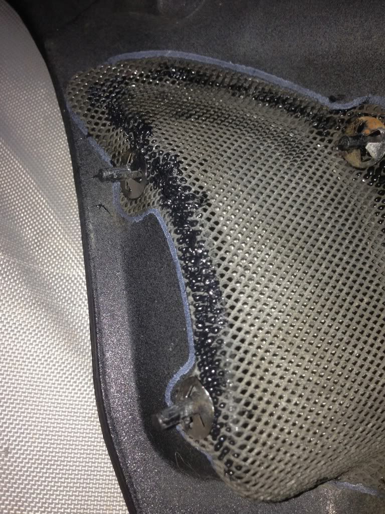

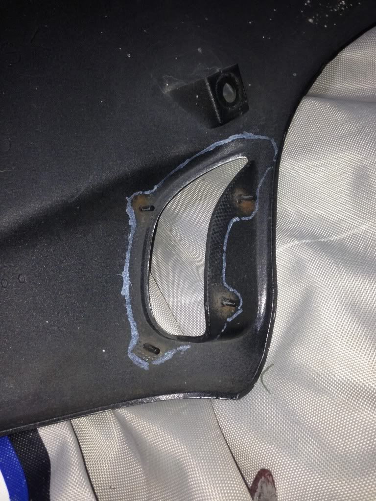

i used a small flat blade to carefully bend the tabs of the grill retaining clips back trying not to snap the moulded plastic posts (use pliers later to flatten back out so they can be reused.
once the grills are removed give them a clean and a paint as they will not be coming back off in a hurry, and give the inside of the fairing a good clean too as the sikaflex will need to bind well to both.

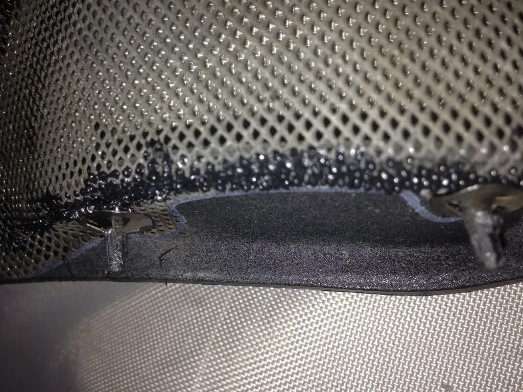

i used the grills to make a quick guide line to follow so i didnt put the sealant everywhere. then did a 2mm wide piping of sikaflex around the edges of the fairing.
press the grills down into the sikaflex so it comes through the weaves.
re install the retaining clips, i used a box spanner to do this but any narrow rigid tube would work, im sure a large pen with the ink removed would work just fine.
