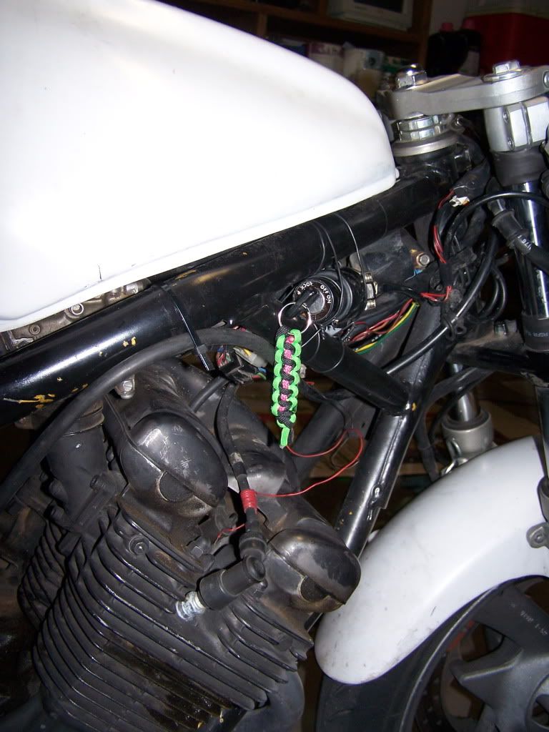

Hi i got 2 ideas:
1. To disassemble the ignition swith to make it shorter and easier to put somewhere else. Has anybody tried it? Can i get some ideas how to solve this problem?
2. Cut off ignition swith and put some remote controll instead. Anybody tried this?
3. What do I need to run without ignition switch?
Thank you

Here's a look inside your ignition switch:
viewtopic.php?f=44&t=719
To cut it down, you'd need to fabricate a blanking plate which could be bolted where the original steering locking mechanism goes. That would take about an inch off the thing. From there, you could relocate it to the side of the headlamp or down near the coils.

Fri Jun 15, 2012 2:24 pm
1. Cutting it isn't fully necessary, but can be done by making the before mentioned plate. It will not work without this plate, I have tried.
Just a mock up I ran with for a while, I am going to run it full time once I get around to doing the mounts and side covers.
2. Do some research on RFID or Remote Start/Ignition applications.
3. Guts and a prayer no thief is going to toggle the starter switch.

Sat Jun 16, 2012 2:55 am
thanks a lot for your help. finally i decided to put another ignition switch that is much smaller than yamaha's one and to fit it like casper did. I'll put a plug there that appeared in newer models of seca2.
