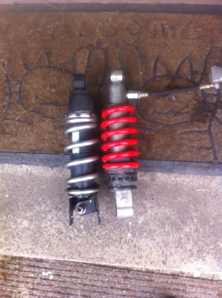

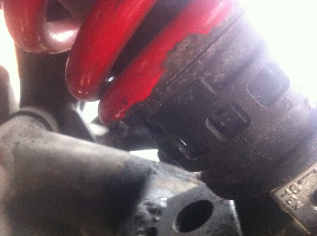

Fitting a Adjustable Honda CBR 600 F4I rear shock
It's about the same length as my ER6 / NINJA 650 shock with my jack up plates.

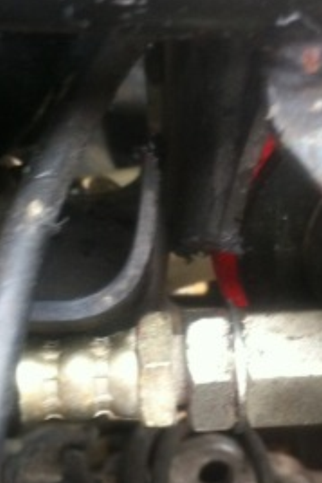

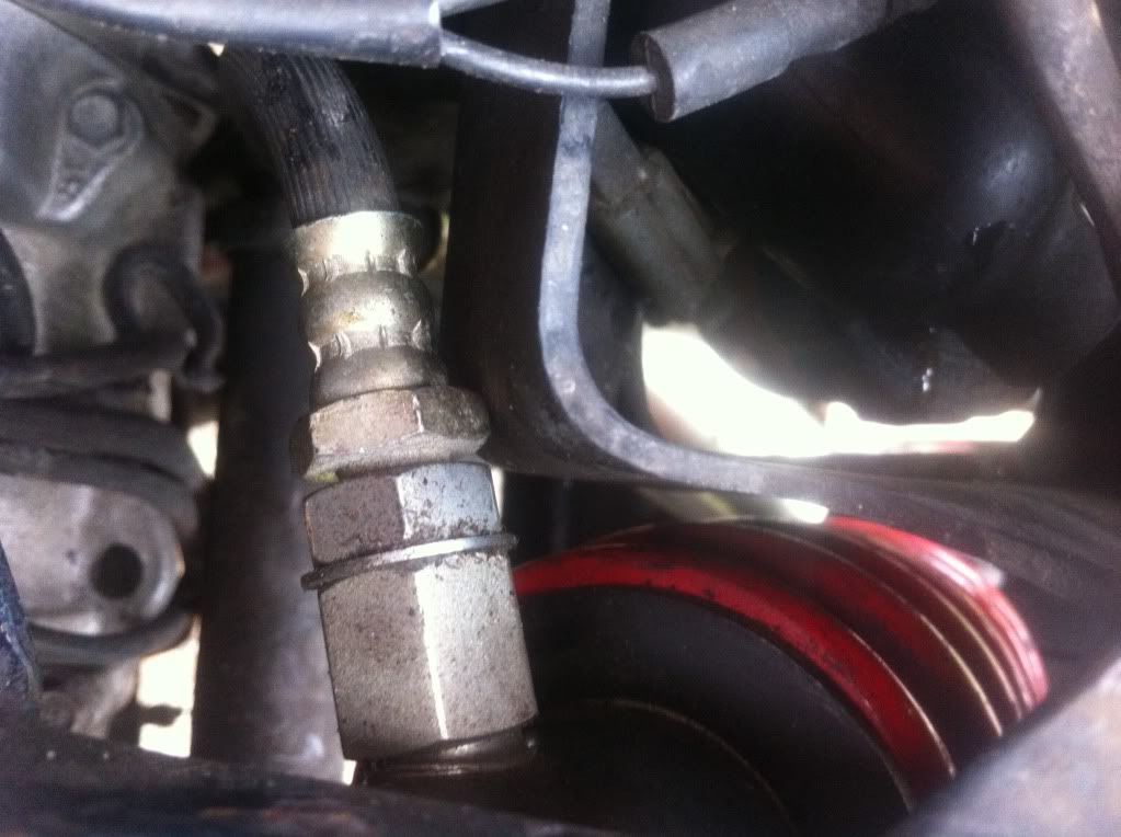

The hose hits the undertray slightly
But with a simple slit threw the plastic with a knife it fits

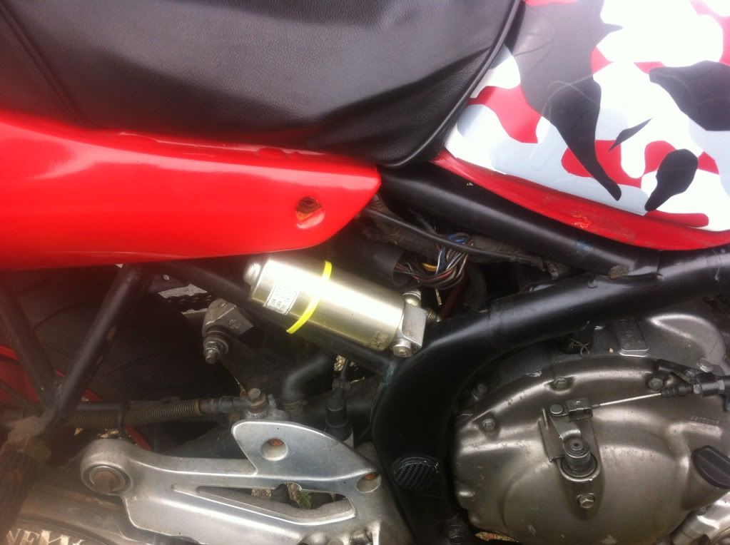

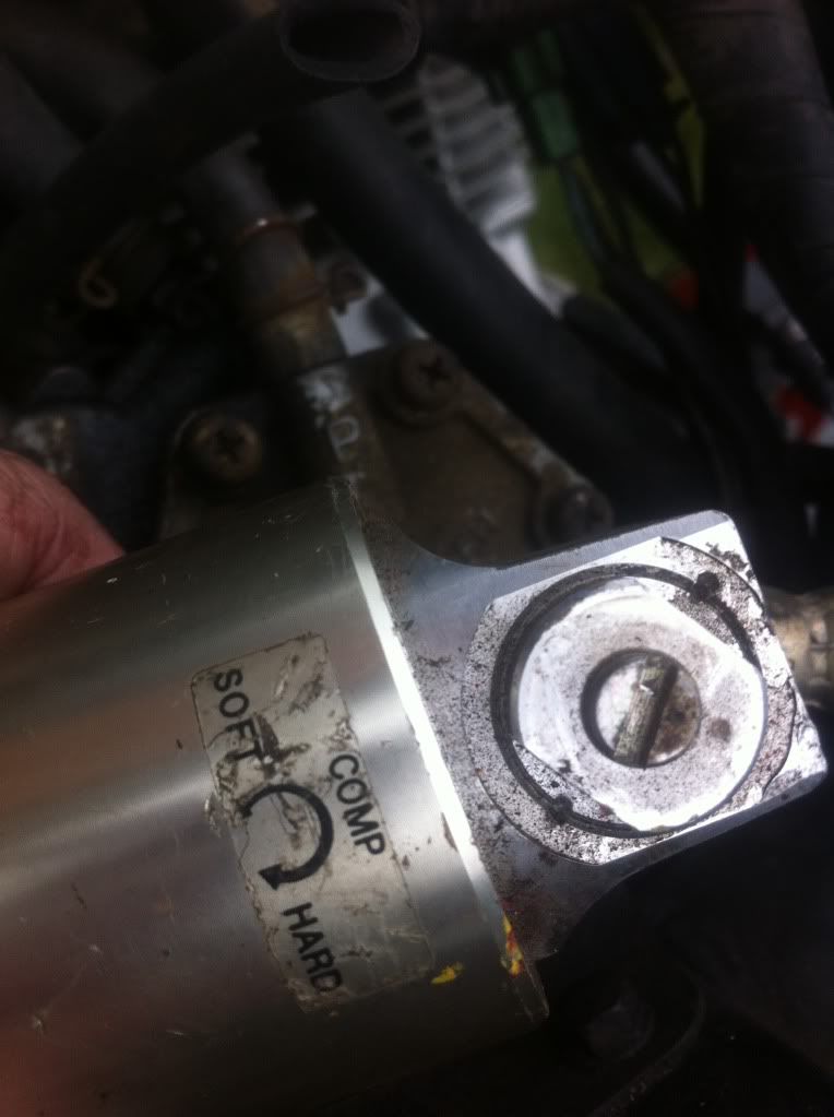

Lots of adjustability!! :)
Not sure how I'm gunna get the side panel back on yet though
Fitting required two 1mm washers at the top and 2 3mm spacers at the bottom
And the holes in the frame reducing down a bolt size.
And the ride hight with the bike stood up straight and the shock on setting 4 of 7.
