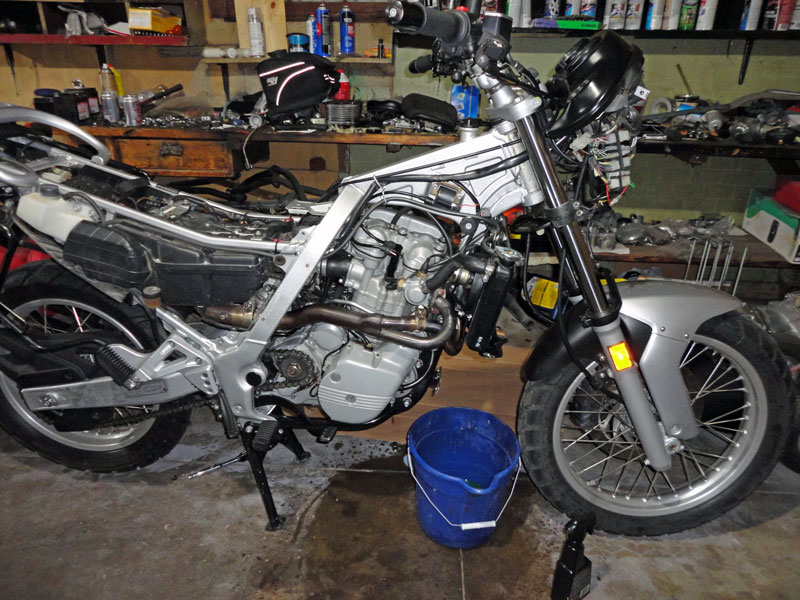

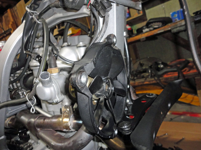

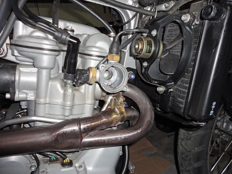

Bike with all the plastics and fuel tank removed for access:

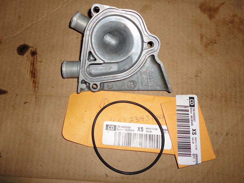

New thermostat and gasket:
Radiator cleaned and flushed (off bike):

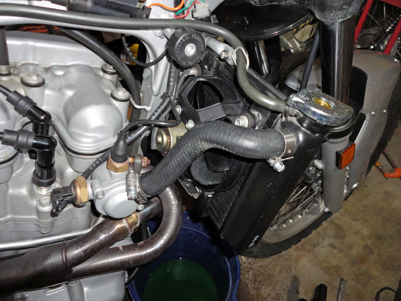

New coolant hoses and stainless protected hose clamps (these have the inner band to keep the worm gear from digging into the hose):
New spark plugs, caps and wires (leads):

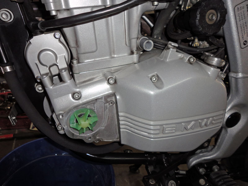

Original water pump. The plastic was originally white but is dyed from years of green coolant. The impellars are loose and brittle.

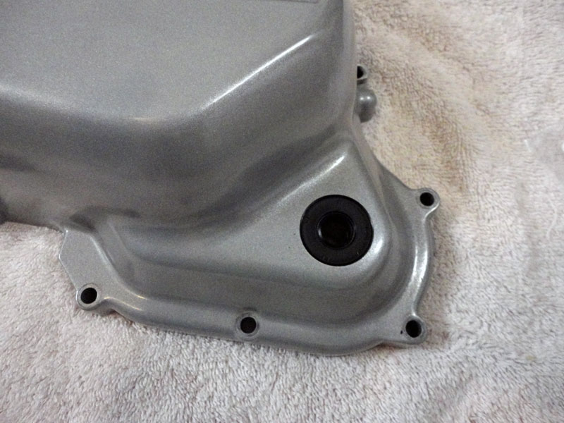

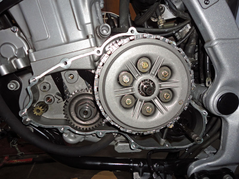

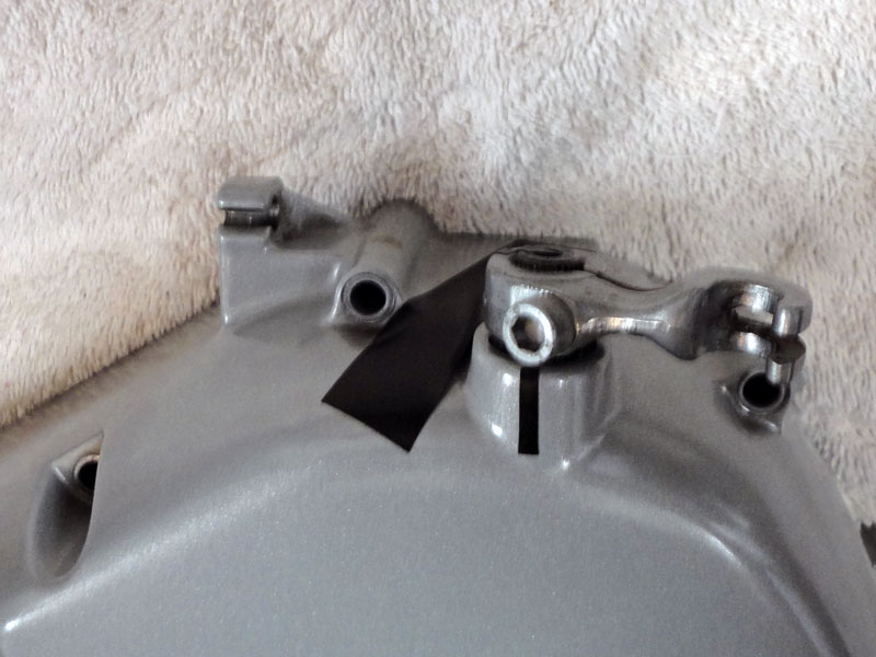

Side cover removed to access the water pump and its drive gear.
While the side cover is off, I took the opportunity to replace the shifter shaft seal and the clutch shaft seal.

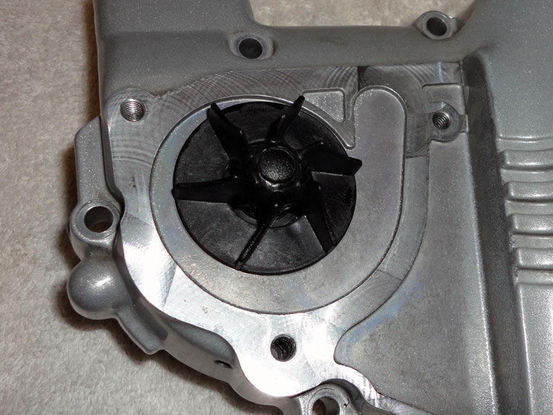

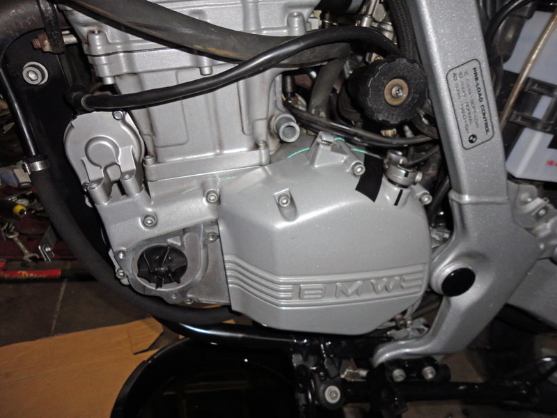

New water pump installed with new oil and water seals.
All buttoned back up with a new side-cover gasket. Alignment of the waterpump drive gear, the clutch shaft and the shifter shaft proved to be tough but once it was all lined up, it slid right back together.

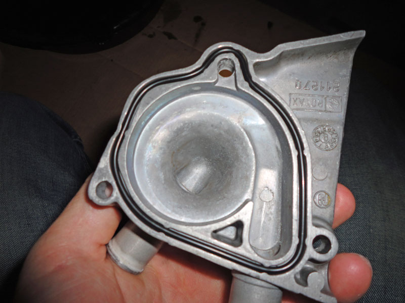

New o-ring and crush washer for the waterpump housing.

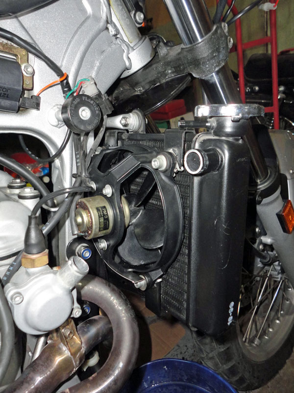

Left side back together with new hoses and clamps.

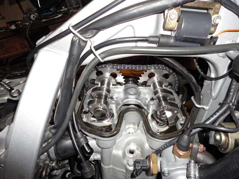

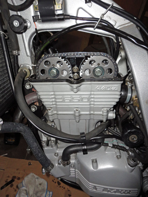

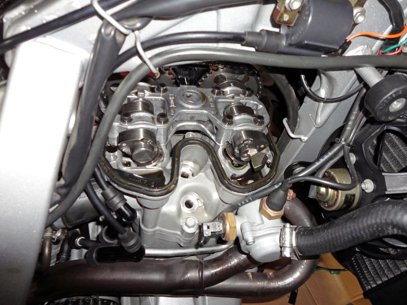

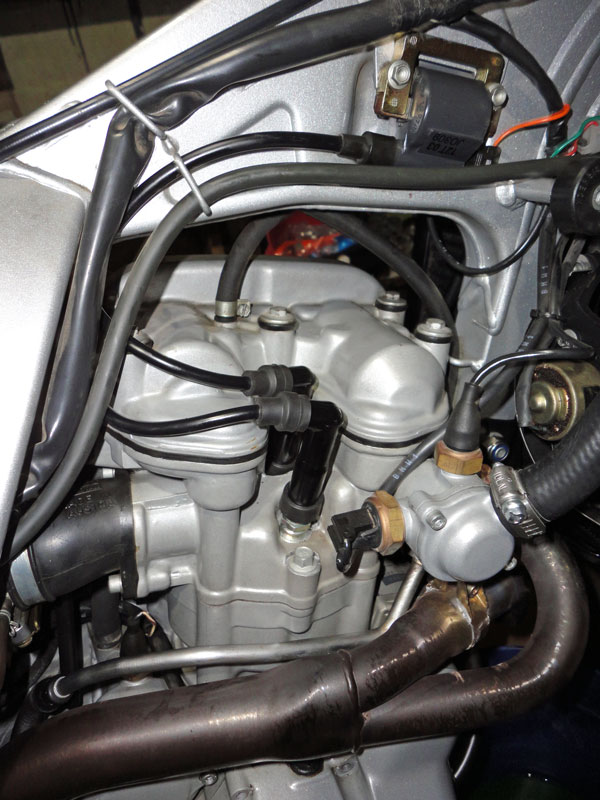

Moving onto the valve adjustment, the drivetrain with the valve cover removed.
The right side intake valve was out of spec. The clearance was specificed at 0.004 to 0.006 inches and it measured out at 0.0015 inches. The remaining valves were all on the loose side, 0.006". I pulled the cams, replace the shim and re-timed the top end.

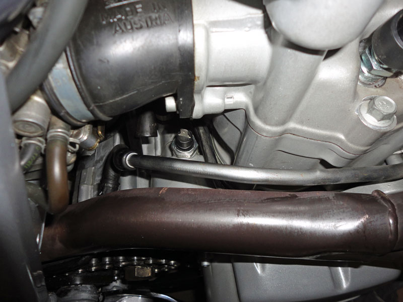

And lastly, a new oil pressure sensor to remedy the leaking original.
