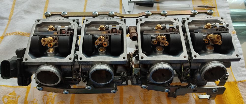

My bike is a '99 XJ600N Diversion (from Spain) and the carburettors are Mikuni BDS28, here they look as if you were mounted on the bike:

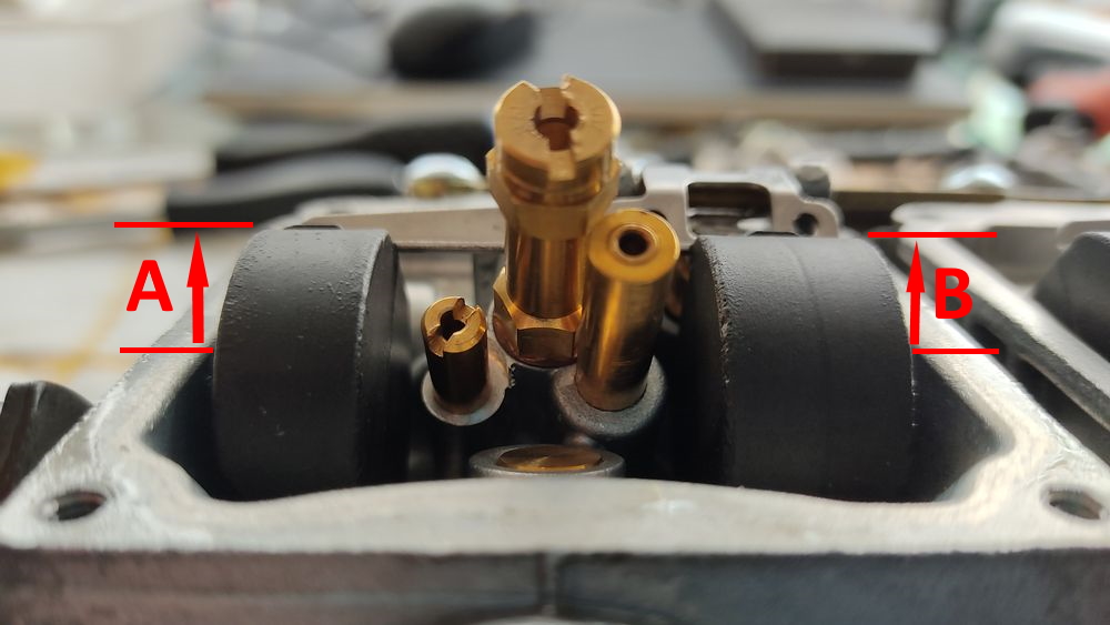

Here are the places where I take the measures on each carburetor:
Here the measurements I have obtained:
Code: Select all
CARBURETTOR       1        2        3        4
A                 10,4mm   10,7mm   11,2mm   11,4mm
B                 10,1mm   10,2mm   10,8mm   10,6mm
The Haynes manual says that for motorcycles from 98 onwards the measurements are between 8.8mm and 10.8mm:
What is the correct measurement if any of them is?
Are the floats defective?
Do I mount everything and forget about it?
